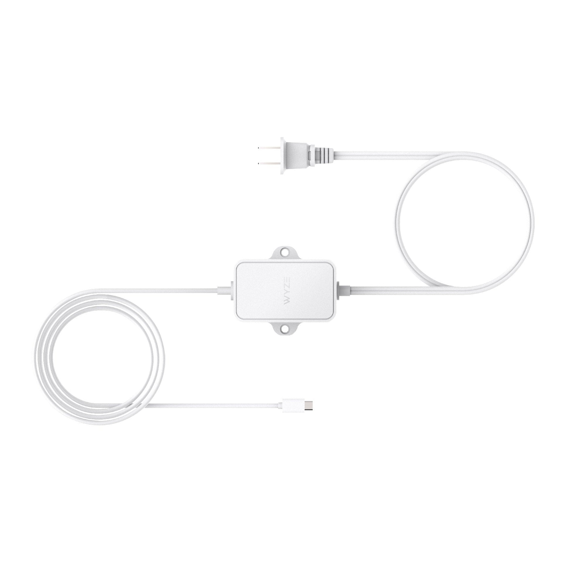

Ready for rain, snow, or shine. IP67 weather-resistant, so you can safely use your Wyze Camera outdoors.
Universal Outdoor Adapter (Latest Model): Works with Cam v3/v3 Pro/v4, OG series, Pan v3/v4, and Duo Cam Pan.

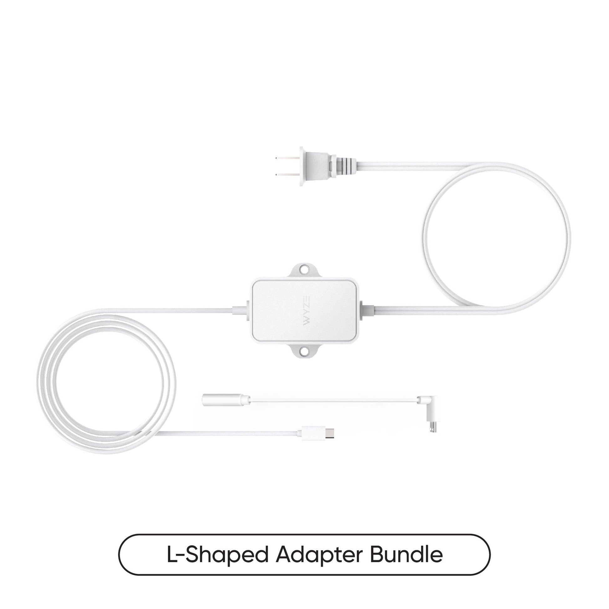

Outdoor Adapter + L-shaped Adapter + USB-C Adapter: Works with Cam v3/v3 Pro/v4, OG series, Pan v3, and Battery Cam Pro.
Adapters will NOT work with OG Stack Kit.

      Dimensions: 78.7 mm x 62.5 mm x 29.4 mm
      Weight: 235 g

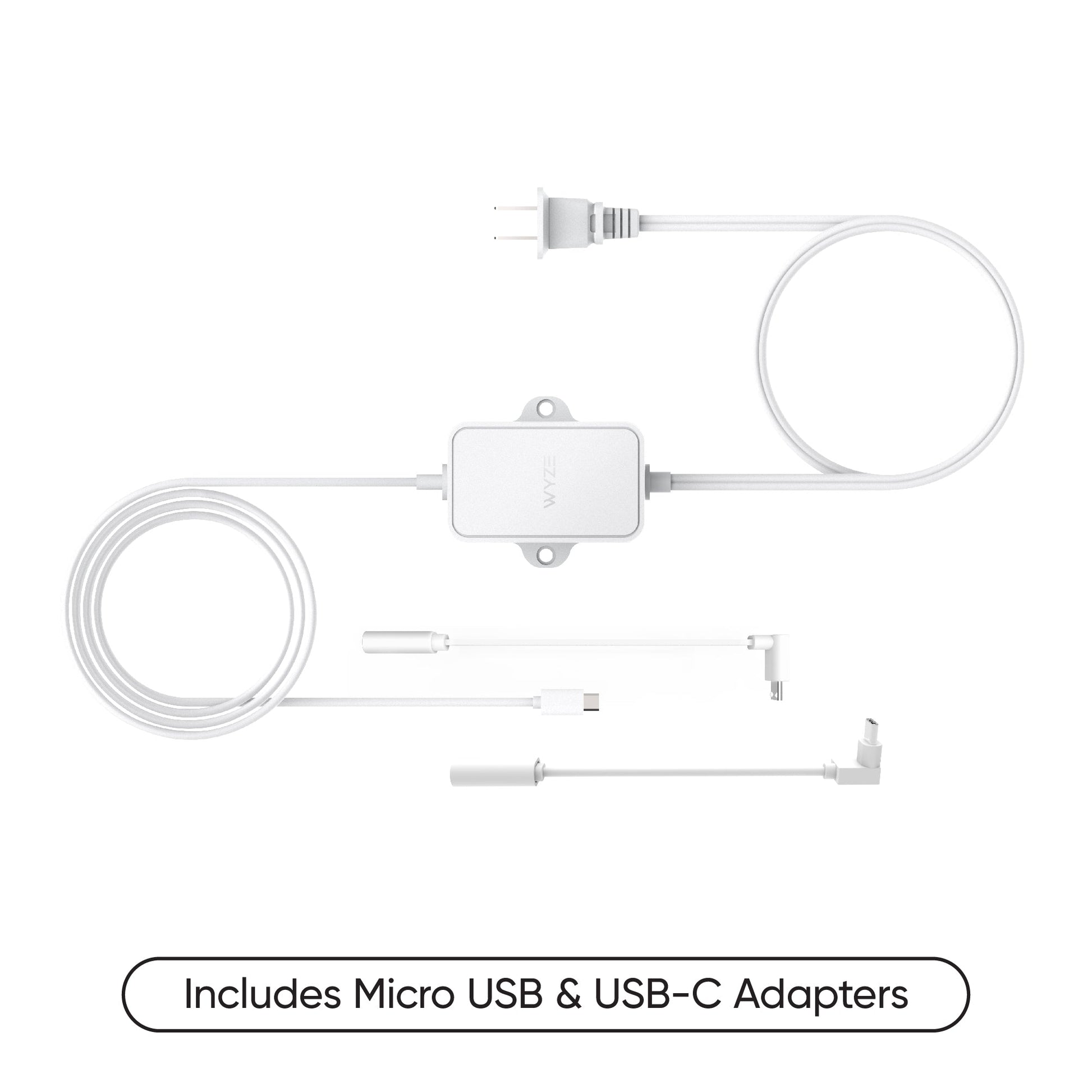

      Outdoor Power Adapter Cable Length:
      • Total cable length: 12.5 ft (3.8 m)
      • AC cable length: 3.9 ft (1.2 m)
      • DC cable length 8.5 ft (2.6 m)

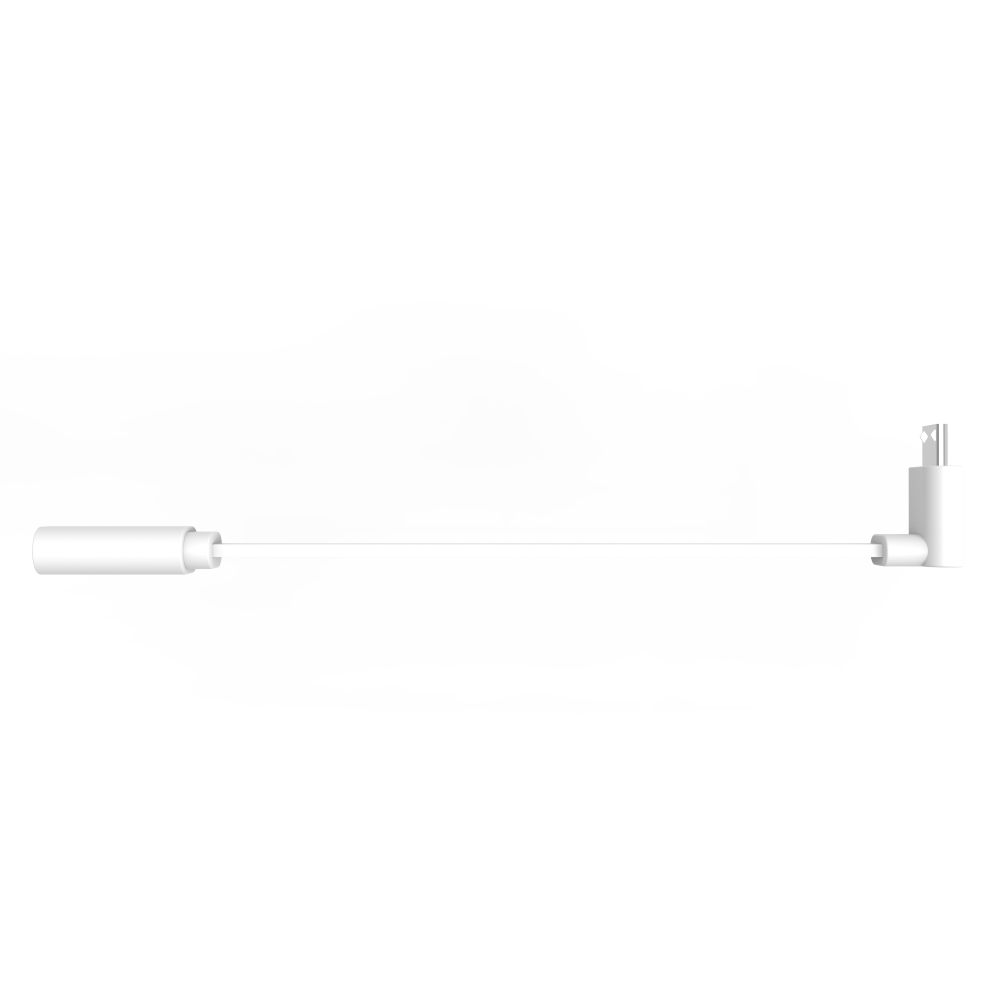

      • L-shaped Adapter: a 4.5 in. female-to-male weatherproof dongle with a 90 degree angled micro USB on the male end

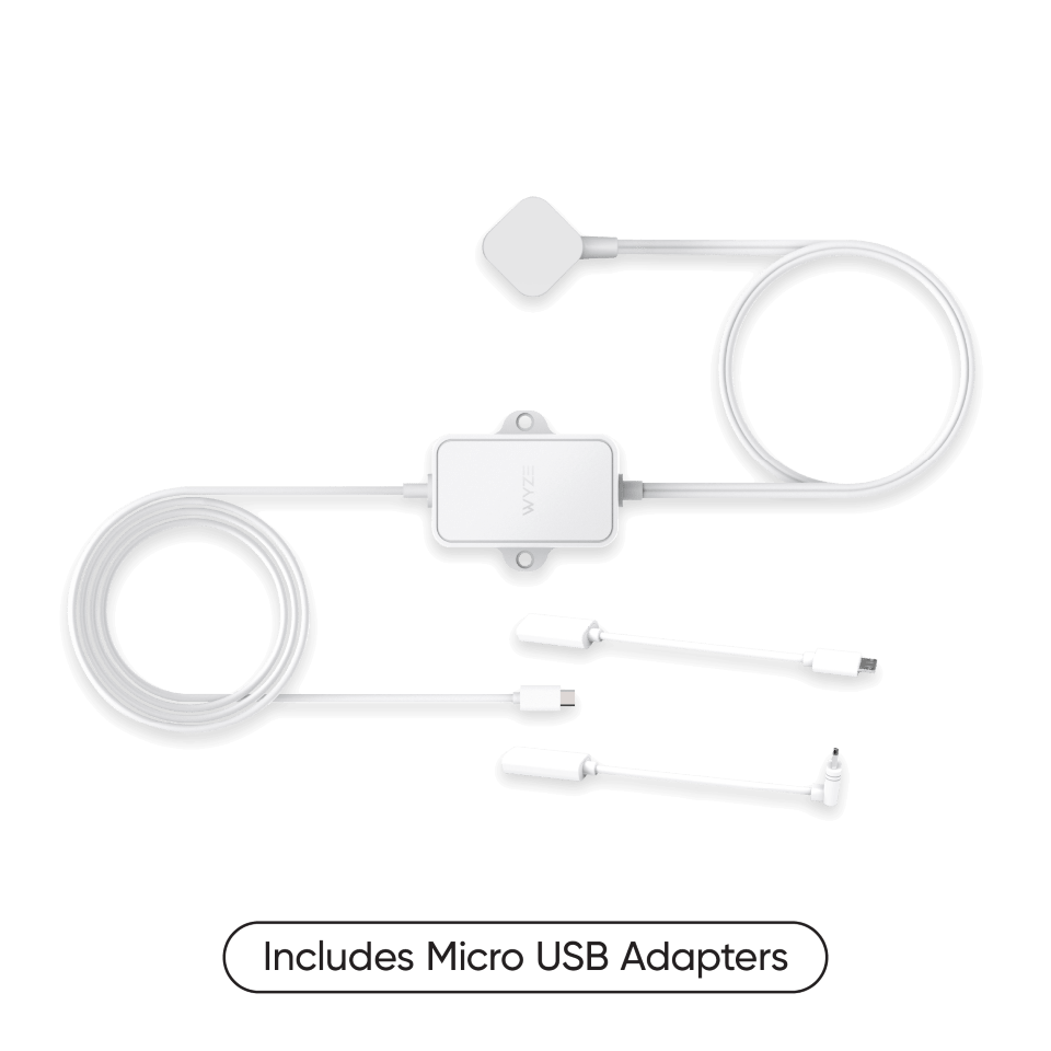

      Universal Outdoor Adapter Cable Length:
      • Total cable length: 19.68 ft (6m)
      • AC cable length: 13.1 ft (3.4m)
      • DC cable length 8.52(2.6m)
      Outdoor Power Adapter + L-shaped + USB-C Compatibility:
      • Outdoor Power Adapter works with Wyze Cam v3/Cam v4 and Cam OG series.
      • Outdoor Power Adapter + L-shaped Adapter works with Wyze Cam Pan v3/Cam v3 Pro.
      • Outdoor Power Adapter + L-shaped USB-C Adapter works with Wyze Battery Cam Pro.
      Universal Outdoor Adapter Compatibility:
      • Works with Cam v3/v3 Pro/v4, OG series, Pan v3/v4, and Duo Cam Pan.
      Powering Methods:
      • Input power: 100v-240v
      • Output power: 5v2A
      Connector to wall plug: 2 pin flat, US
      Operating Temperature: -22℉ - 122℉ (-30°C - 50°C)
      Weather Resistance: IP67 Weather Resistant
      Certification: FCC, UL
      Warranty: 1-Year
      • 1x Wyze Cam Universal Outdoor Power Adapter
      • 1x L-Shape Micro USB Connector Cable (Type C Female to L-Shape Micro USB Male)
      • 1x Micro USB Connector Cable (Type C Female to Micro USB Male)
      • 12x Wire Clips
      • 12x Screws
      • 12x Screw Anchors
      • 1x Wyze Outdoor Power Adapter
      • 8x Wire Clip
      • 6x Screw
      • 2x Attached Cable Wrap (White)
      • 6x Screw Anchor
      L-shaped Adapter
      • 1x Weatherproof L-shaped Micro-USB Adapter
      The total length of the cable is 12.5 ft (3.8 m), with the AC cord and DC cables together.
      Wyze Outdoor Power Adapter includes wire clips, screws, screw anchors, and a cable wrap. These accessories are designed to hold the adapter and cable to the wall.
      The Outdoor Power Adapter + L-shaped Micro USB Adapter Bundle also includes a weatherproof dongle with a 90 degree angled micro USB to allow it to connect to the Wyze Cam Pan v3 and Cam v3 Pro.
      The Outdoor Power Adapter + L-shaped Micro USB Adapter + L-shaped USB-C Bundle includes everything you need to connect to the Wyze Cam v3/v3 Pro/v4, Cam Pan v3 and Battery Cam Pro.

      Additionally, the Wyze Outdoor Power Adapter will only work with the Wyze Cam Pan v3 and the Cam v3 Pro when paired with the L-shaped Micro USB Adapter. For Battery Cam Pro, the Wyze Outdoor Power Adapter must be paired with the L-shaped USC-C Adapter.
