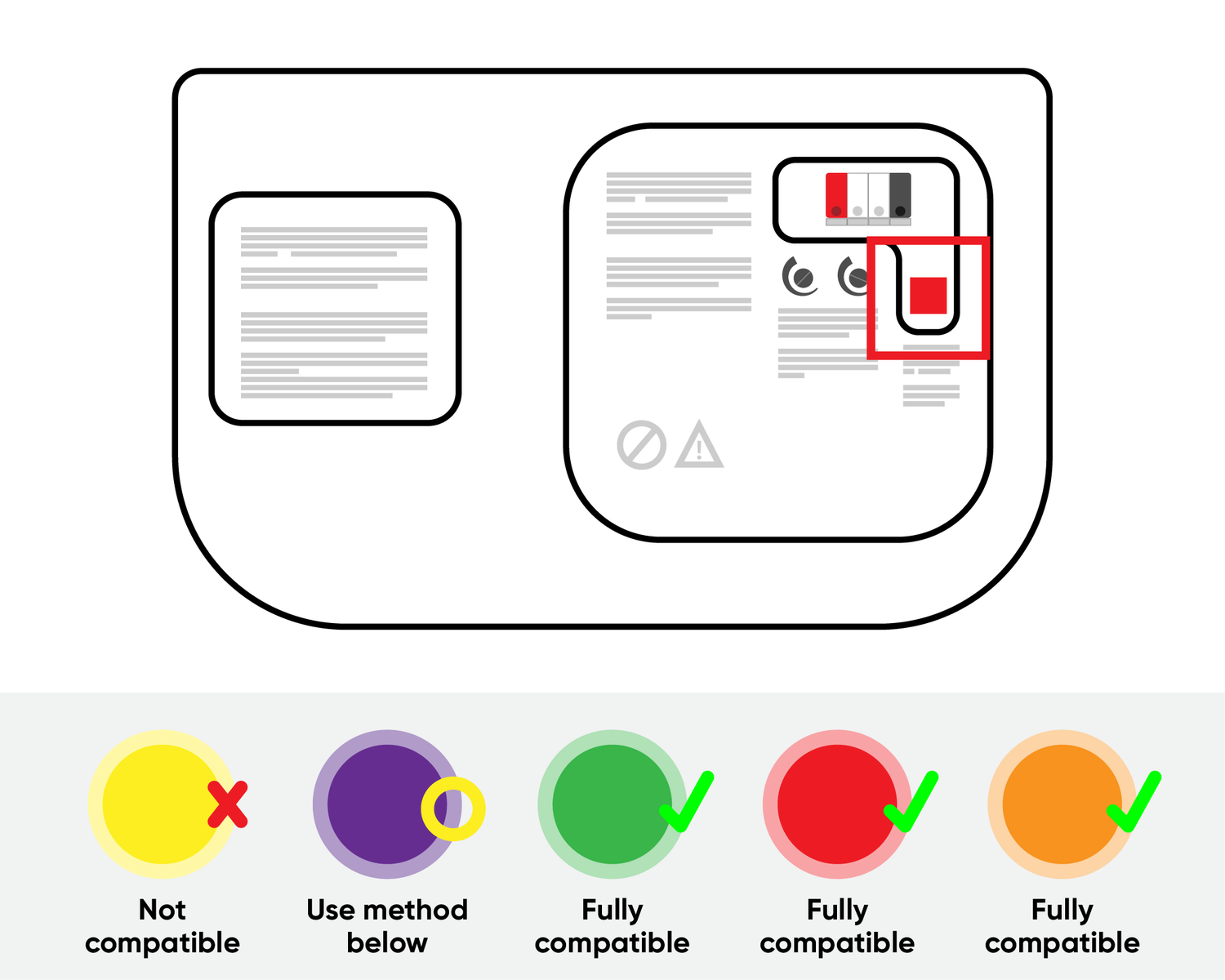

1. Check your Learn Button.
If your existing garage opener is from Chamberlin, LiftMaster, or Craftsman, find the "Learn" button on your garage door opener. If it is green, red, or orange, Wyze Garage Door Controller is compatible.
If your Learn button is a different color or you cannot find it, try option 2.

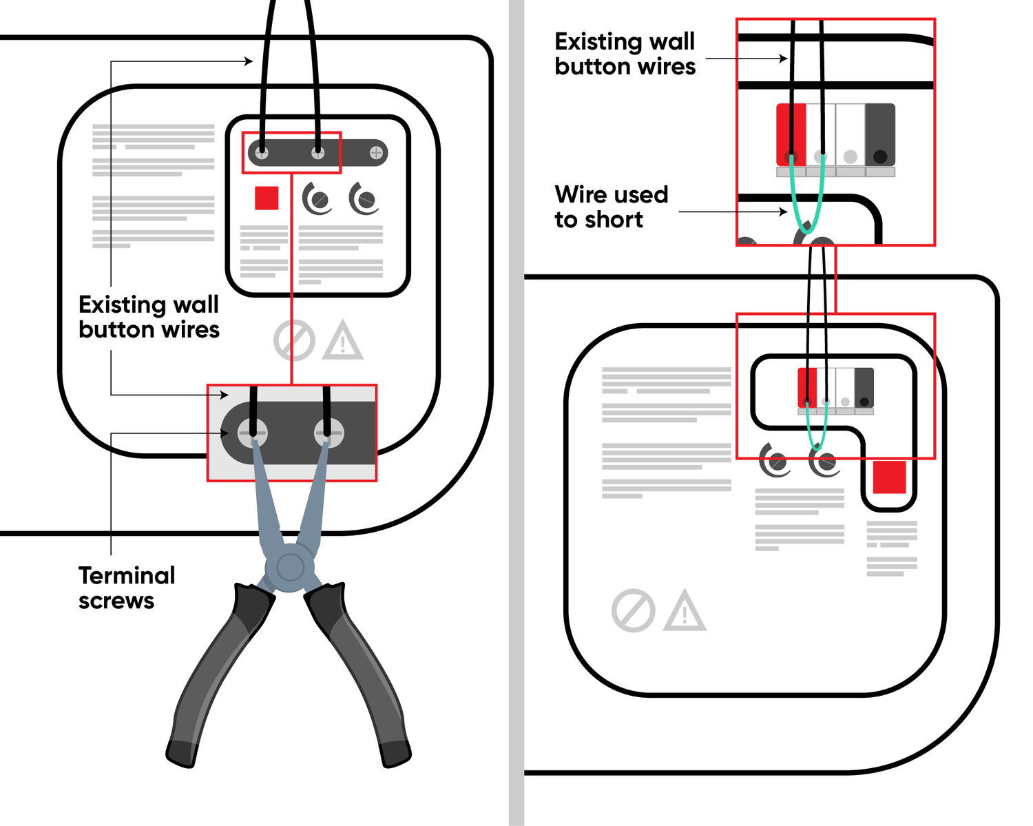

A diagram showing how to wire a device using pliers and a compatibility page.
2. Short the Terminals.
Note: This is a safe procedure.
Use a pair of needle nose pliers to short the wall button terminals. If the garage door opens or closes, Wyze Garage Door Controller is fully compatible.
If nothing happens, search for your specific garage door opener in the list below.
